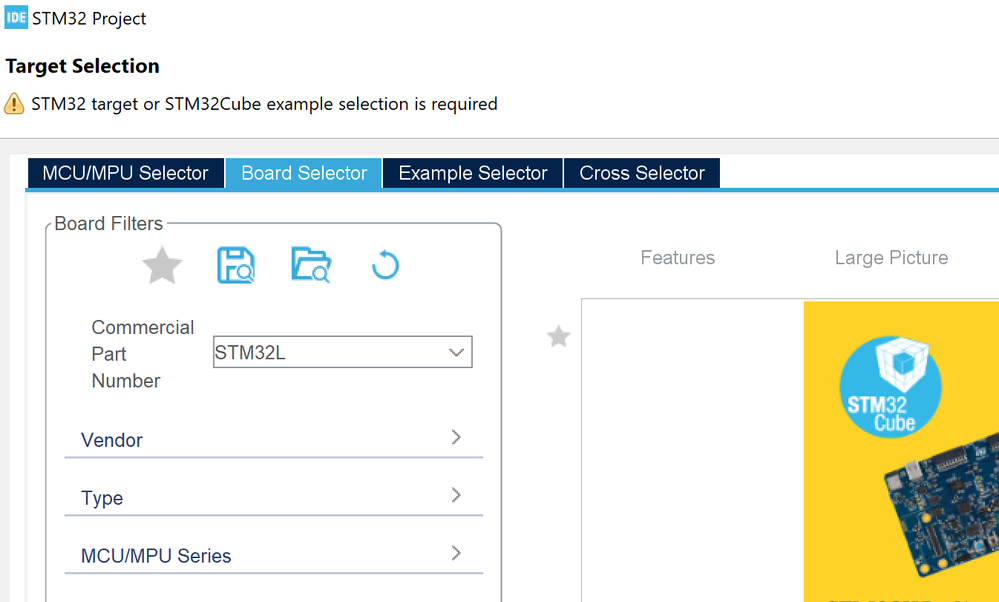

2022-12-09 8:01 AM
Then open it start new STM32 project wizard and choice your board
complete firmware pack install and empty project ...
Close it and open folder with repository on windows for example
c:\Users\username\STM32Cube\Repository\STM32Cube_FW_L0_V1.12.1\Projects\32L0538DISCOVERY\
here is Demo app, examples and docs.... ofcourse for you L1_V...

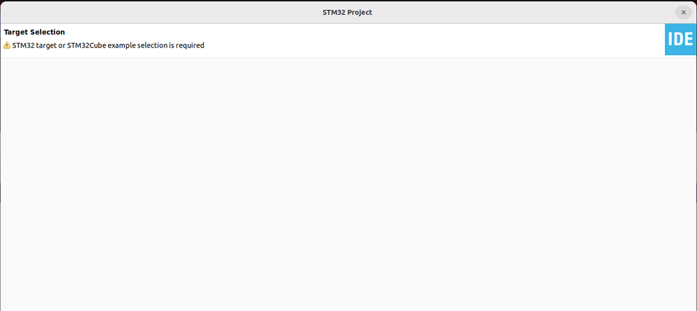

2022-12-09 8:35 AM
Got the Stm32CUBE to work - turns out there is a conflict between Wayland and the Eclipse tooling. When I disabled Wayland things worked.

You can load a bunch of examples in STM32CubeIDE with File -> New -> STM32 Project -> Example Selector.
There are also more that can be seen here:
https://github.com/STMicroelectronics/STM32CubeL1/tree/master/Projects

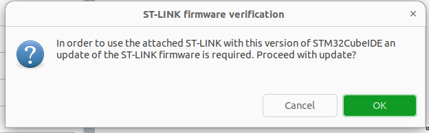

Thank you for various answers. An Arduino is on the way.
I must admit I had expected the point of a "Discovery kit" was to provide a quite polished experience, but I guess I'll get there. Right now I am trying to compile the example which was instantiated when I selected the stm32L1 Discory kit. Compilation seems to work - no errors in the console - but when I try to "Run" (whatever that means in this context) I get the following window:
