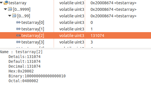

Hello, I'm using the STM32746G Discovery Board to familiarize myself with the ST environment. Now I simply wanted to store a 32Bit value in the RAM, and had several problems with the Cube BSP drivers. I tested the functions with the following code:
#define SDRAM_OFFSET ((uint32_t)0xC0100000)
for(uint32_t i=0; i<0x10010; i++){
BSP_SDRAM_WriteData(SDRAM_OFFSET+i*4,(uint32_t *)&i,1);
testarray[i]= 0;
if(SDRAM_OK != BSP_SDRAM_ReadData(SDRAM_OFFSET+i*4,(uint32_t *)(&testarray[i]),1)){
testarray[i] = 111111;
}In the debugger it then looks like this:
Sometimes the transfer works. Sometimes the higher bits are incorrect.
How do I use the function to make it work?

2019-01-15 5:15 AM
I am still struggling with this problem. Does nobody have any suggestions or tips for me?
2019-01-15 6:02 AM
testarray is in Internal SRAM
0x10010 is significantly larger than 10000 decimal (0..9999)
SDRAM writes like other memory, you could just use a pointer.
