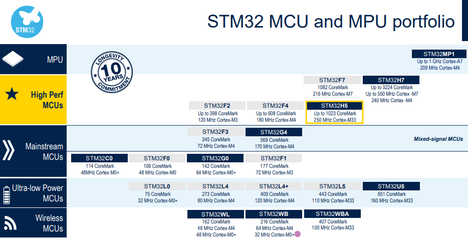

Hello @AMend.7 ,
The new STM32H5 series comes to complete the STM32 High Performance MCUs portfolio.
It comes to complete the STM32F4 series not the STM32G4.
For more details, you can check the Product Presentation : STM32H5 MCU series Most powerful Arm® Cortex®-M33 MCU yet
Foued

I think it's not worth making a cortex-m33 that fast, for that it's better to use H7 which has 64bit buses, double precision FPU, etc. A 250MHZ cortex-m33 has the equivalent performance of a high-performance DSC for power convertion, with the advantages of costing much less, consuming less energy and being much easier to program. ST just didn't put the necessary analog peripherals for the H5 to become competitive in this segment. I was hoping for an H5 with the peripherals of the G4.

Hello @AMend.7 ,
Foued
