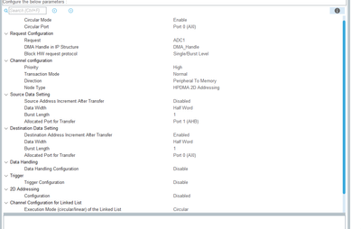

Hi @CMYL
Your code for regular DMA cannot be used with GPDMA and HPDMA.
I successfully ran Continuous Conversion Mode and DMA Circular Mode after enabling HPDMA and ADC in CubeMX.

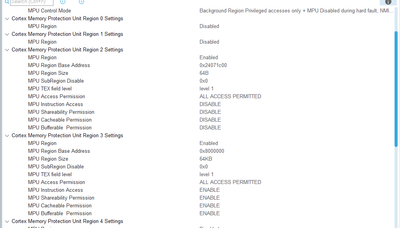

2024-08-15 2:25 PM - edited 2024-08-15 2:26 PM
I deeply reviewed your questions. Here the answers to questions 1 and 2.
(I keep the answers to 3 and 4 in the next prompt window.)
//hadc1.Init.ContinuousConvMode = DISABLE; // --> ENABLE
hadc1.Init.ContinuousConvMode = ENABLE;
hadc1.Init.ExternalTrigConv = ADC_SOFTWARE_START;
Thanks
2024-08-15 4:41 PM
For the following questions 3 and 4 below:
Answers:
- Please find my Step -by-Step demo in the attached document ADC_DMA_circular_usingSTM32CubeMx.pdf
- For the setting of STM32CubeIDE to avoid loading the boot binary each time you want to debug see attached document H7S_CubeIDE_config_Howto - Copy.pdf
- The whole project is attached ADC1_HPDMA_CircularMode.zip
Best Regards,
Younes
