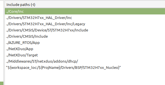

It first looked like this in the project it was copied from:

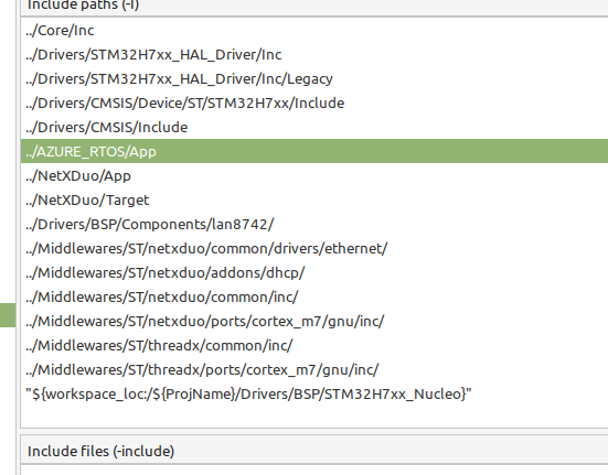

then it turned into this after the regeneration:
To fix it I had to go back through and manually add the paths back.
I used the method of right click on the folder of interest in the project tree and select "Add/Remove include path".
I double checked that making a copy of the project would copy the include paths correctly so it was definitely a fault of the regeneration after the Addons DHCP Client feature was unchecked in the Software Packs Component Selector.
