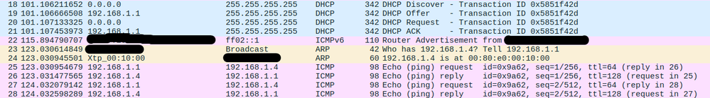

2025-08-08 2:56 AM
After retesting and downloading your project with the suggested adjustments, I can confirm that it works. As shown in the Wireshark screenshot below, the board is discovered by the DHCP server and obtains a valid IP address. I was able to successfully ping the board and receive responses.
As a suggestion, please ensure your DHCP server is functioning correctly. You might also have made other changes in your project. To help, I have attached a copy of the working project—please build and flash it to your MCU, then share your feedback. I’ll be happy to assist further.
