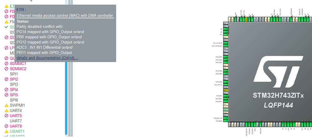

I inserted in it valid .ioc & .ld from you - this did not help. Even more - this ioc gave me next problems with Ethernet:

Actually your project has wrong ETHERNET GPIO Settings - Nucleo board use other pins !!
I have looked the official document - mb1364-h743zi-c01_schematic.pdf
And yes, you are right - the two pins TX_EN and TXD0 are connected to another pins compare to official STM's ioc file for this H743ZI2 board. Strange! Why ioc file was not tested?
