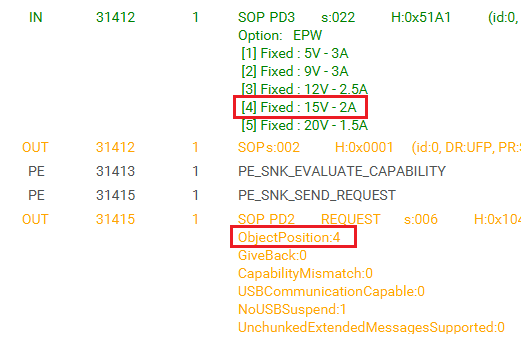

I just compiled and tested your application, it works fine and I am able to select the 15V PDO.
I even flashed the binary you compiled on your PC (as you sent it with the project in your previous message). It works fine and selects the 15V PDO.
As you can see in my trace, the sink asks for position 4 which correspond to 15V.
I suggest you to retry by first erasing your STM32 completely (using STM32CubeProgrammer), then re-flash.

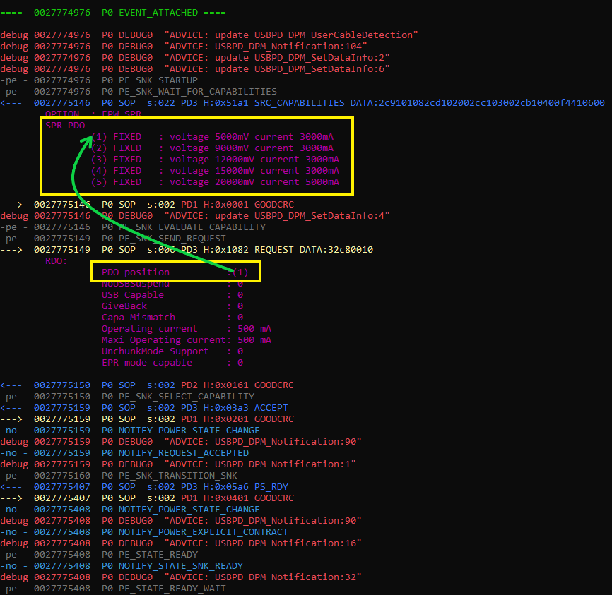

2021-11-04 1:53 AM
2021-11-04 6:58 AM
As can be seen in the trace, your source support 5 PDO (5V, 9V, 12V, 15V an 20V), but your sink asks for the 5V PDO (the first one).
Assuming you followed application note AN5418, you built the most simple sink possible, which doesn't handles matching the sink and source PDO. This must be done with user code.
This is done in USBPD_DPM_SNK_EvaluateCapabilities function. If you followed the application note, this function does nothing more than to ask for the first available source PDO, which in your case is 5V.
In order to select the 9V PDO, you must select PDO number 2 (in your case). This can be done with user code that matches the sink PDO you defined in CubeMX, and the corresponding available source PDO.
I suggest you to take look at a possible implementation of this system in this more complete example: https://github.com/STMicroelectronics/x-cube-tcpp/tree/main/Projects/NUCLEO-G071RB/Applications/USB_PD/SNK1M1_Sink.
