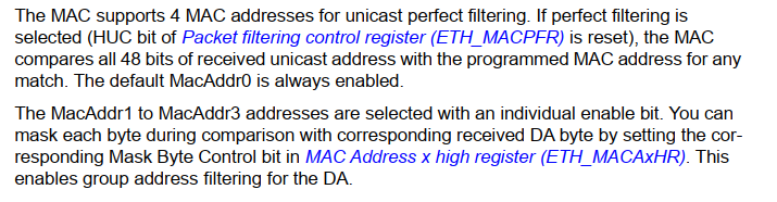

According to RM0399, STM32h745 controller supports 4 independent MACs I have added a snip for reference
It says by default, the MacAddr0 is enabled. We were successfully able to transmit and receive frames from MacAddr0.

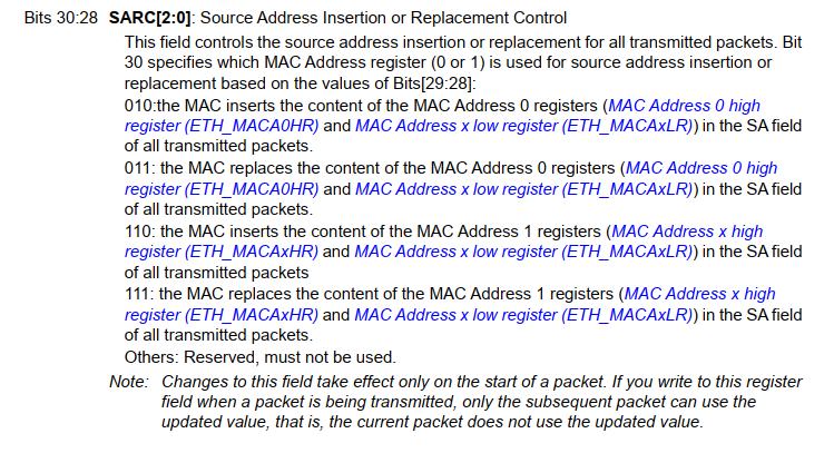

In order to transmit and receive from MacAddr2 we have enabled the AE bit in ETH_MACxHR (x=1), but the issue is as we can see there is no provision given in the SARC[2:0] fields of ETH_MACCR for the MacAddr2 and MacAddr3 .
As it says in RM0399 page N0:3112 ,it shows that 010:the MAC inserts the content of the MAC Address 0 registers and 110: the MAC inserts the content of the MAC Address 1 registers .so where are the MAC insert contents of the MAC Address 2 and MAC Address3? could you please elaborate this .
