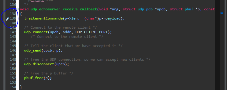

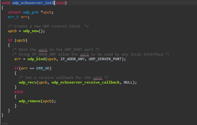

Have a question about how to debug in the udp_receive_callback function. In fact, I have done some stuff there but I am trying to debug there (put breakpoints inside of udp_receive_callback but it never goes there ...) without success until now.
You can see it in those pictures attached.
Any idea how to handle it?
Thank you
2021-09-08 7:08 AM
Hello @LBadi.1 ,
Try to reduce the optimization level to 0 in order to debug the callback function.
BeST Regards,
Walid
