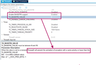

Actually the BASEPRI support is available in ThreadX and configurable in STM32CubeMX.
regards
haithem.

2025-07-15 2:40 AM
regards
haithem.
2025-07-22 3:05 AM
Hello @Haithem Rahmani
Okay so essentially there is no fixed absolute limit and it is up to developer's discretion what the BASEPRI value is?
I don't fully understand the intended benefit of it in that case, but this answers my initial question regardless.
Much thanks!
