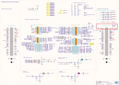

Did you connect the SB9 and SB20 solder bridges?

Yes; keeping in mind that those two pins are still connected to SDMMC socket, see schematics and the Nucleo board's manual.
