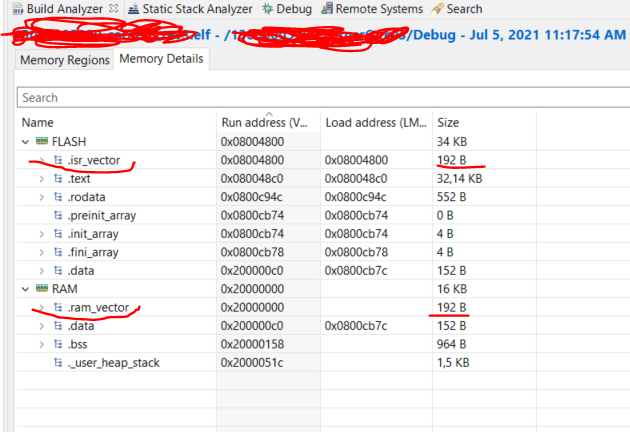

ram_vector looks like its corectly reserved by the linker at the beggining of ram

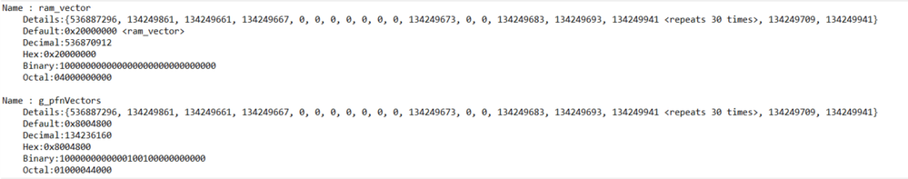

ram_vector also gets succesfully filled with the correct vectors
