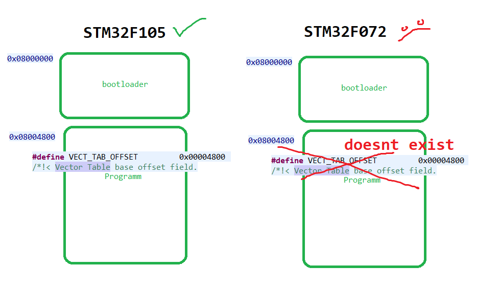

I developed my first canbus bootloader for a stm32f105.
Now im in need to use that same bootloader in a stm32f072.
The bootloader works but im unable to build a program that starts from a flash address other than 0x8000000.....
How are multi programm apps being programmes in stm32f0xx families?

2021-06-22 8:08 AM
okay, i found someone with my same issue in stack overflow
https://stackoverflow.com/questions/64152604/no-vtor-offset-given-in-stm32f072
2021-06-22 8:10 AM
There's no VTOR register in Cortex-M0.
You have to remap RAM to the 0x0000'0000 area (see SYSCFG_CFGR1.MEM_MODE), and copy the custom vector table (from the application's beginning) there.
