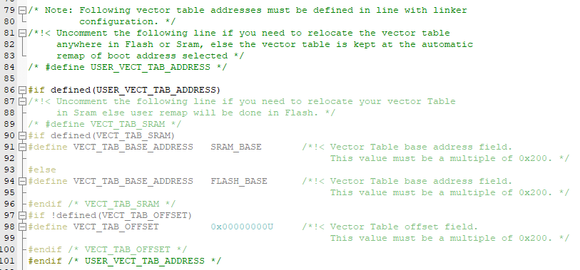

2026-04-20 7:58 AM
It's grayed out:
Uncomment this define:
#define USER_VECT_TAB_ADDRESS
I don't know why it is commented out by default.
2026-04-20 6:42 PM
Other projects have similar annotations. If the default interrupt vector table configuration is used, this macro can be commented out.
I suspect that the VTOR register of L152 was not correctly assigned the default value (0x0x08000000) after power on, which resulted in the need to reassign the correct value in SystemInit().
