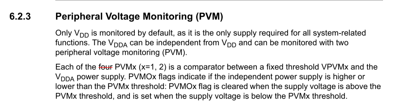

In RM0440 R6 6.2.3 there is "Each of the four PVMx (x=1, 2)". So 4 or 2 PVM ?

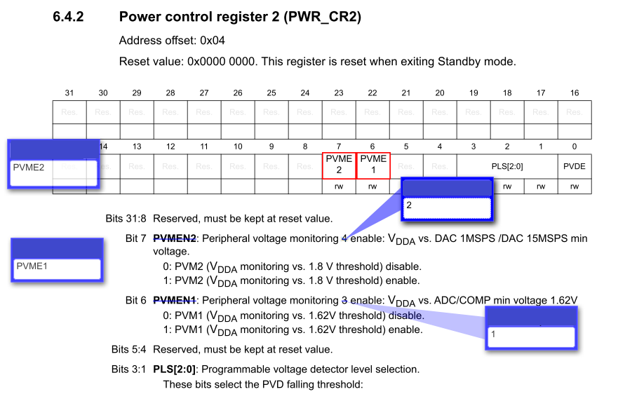

In the PWR_CR2 register 6.4.2:
Bit 7 PVMEN2: Peripheral voltage monitoring 4 enable
Bit 6 PVMEN1: Peripheral voltage monitoring 3 enable
=> PVMEN1 is for PVM1 or PVM3?
=> Only 2 PWM specified

Hello @Nikita91 ,
Thank you for pointing out this issue.
In STM32G4xx, there is only 2 PVMx (x=1,2).
So, in RM0440 the PVMENx should be renamed to PVMEx (to be in line with HAL definitions):
Also, the mistake of 4 PVM thresholds will be corrected and this text should be updated (remove "..the four") :
Note that the next revision of the RM0440 is planned in the first quarter of 2022.
Thank you once more for your contribution.

Hello @Nikita91 ,

But what is the correct PWR_CR2 bit to use for PVM1: bit 6 as in RM or bit 4 as in stm32G431xx.h ?
2021-12-14 6:32 AM
It's Bit 6. as in RM0440.
