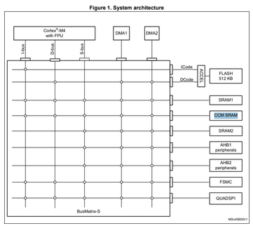

Thanks for the explaination. To further clarify, from RM0440 figure 1, it looks like CCM SRAM is connected to both instruction and data buses, as well as DMA peripherals:
So this would mean I can place not only code but also initialize data in this area correct? And for the usage, I see under RM0440 2.4:
CCM SRAM is mapped at address 0x1000 0000.
Execution can be performed from CCM SRAM with maximum performance without any
remap thanks to access through ICode bus.
The CCM SRAM is aliased at address following the end of SRAM2 (0x2000 5800 for
category 2 devices, 0x2001 8000 for category 3 devices, 0x2001 8000 for category 4
devices), offering a continuous address space with the SRAM1 and SRAM2. CCM can be
accessed by DMA only by this aliased address.
Does this mean for non DMA usage I should be referencing to CCM SRAM in the linker script with the 0x10000000 address?
2025-11-30 12:36 AM
If your code perfomance is fine and you don't have any specific requirements, ignore that CCM SRAM is special.
Otherwise, I suggest studying Application note AN4296 "Use STM32F3/STM32G4 CCM SRAM" which has many details on the topic. The app note does not cover VS Code Extension however, so there may be subtile differences in the linker files, startup code etc. and you may have to tweak those.
