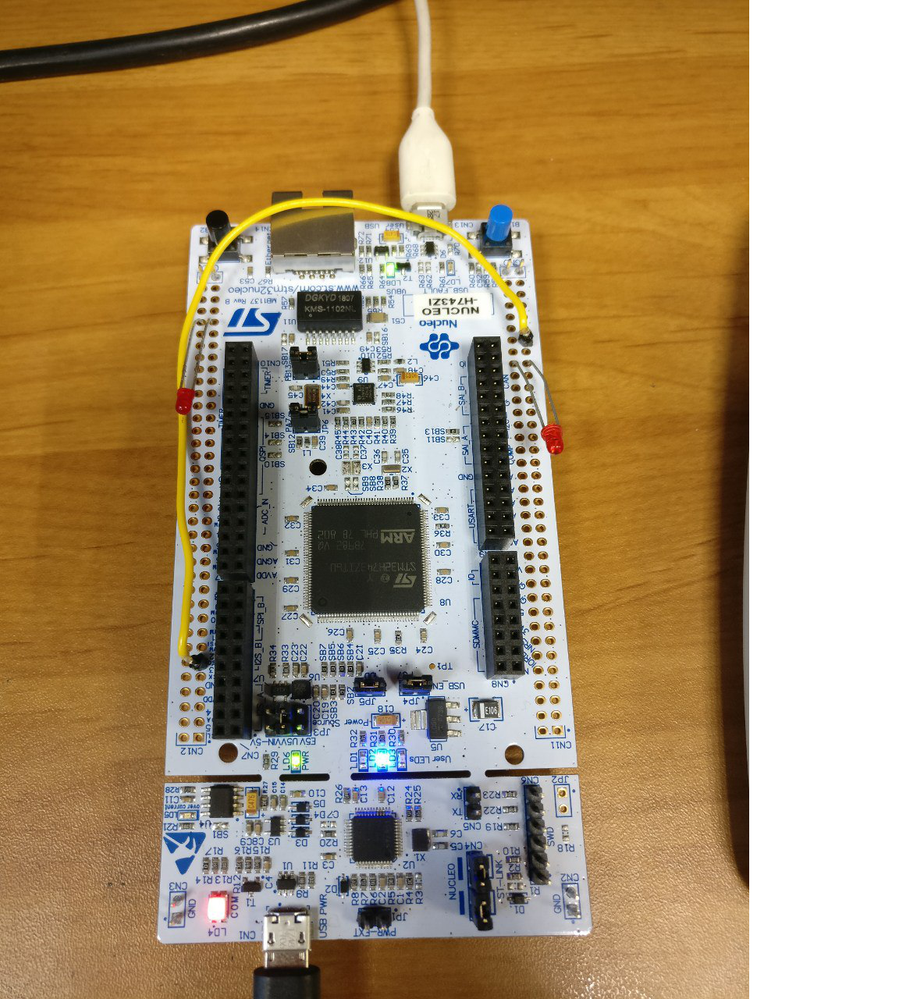

What I do now:
And just build it and flash it. The only COM port I saw it's ST-Link (com3)
As sanity check: usb cabel connected to both usb_connectors on board (not only to ST-Link micro usb) after connecting usb to main part of the board LD8 (green) lights up.
The blinking blue led just for debugging purposes, to make sure that board was flashed.
But I don't see another COM port into device manager, only the ST-link one:

2018-08-14 6:38 AM

2018-08-15 6:40 AM
I did, and my device manager discover some unknown usb device, but there is no description to it.
And this is really amaze to me, why does native example doesn't work correctly (I checked that all pins on EVAL board the same as on nucleo)
