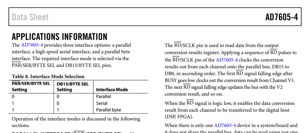

https://www.analog.com/media/en/technical-documentation/data-sheets/AD7605-4.pdf#page=23
You need to study those sections - they define what you need to implement in the host microcontroller.
The AD7605 neither knows nor cares what microcontroller you use - it just has to follow those specifications.

There is Applications Information in the Datasheet - the interfaces are described there:

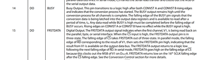

If you will use FMC, you need to synchronize the reading from that ADC:
And I recommend to disable the cache of the FMC memory region on which the ADC will be mapped using MPU.
