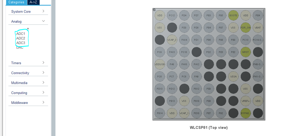

STM32F446 has Maaaaaaany ADC channels distributed into 3 different ADC periprherals.

and can they be synchronised? So that the 2 "stereo" samples actually happen at the same time.
Yes, different ADCs can be syncronized. (not the channels, those are going to be converted in a waterfall fashion)
