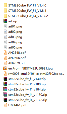

Have you already install STM32Cube?
if yes you can find a lot of example under C:\Users\"username"\STM32Cube\Repository
You should find something useful for you there

Thanks for your information, but I don't find some samples here:Thanks

2022-10-03 7:27 AM
Go down a few directories
Repository\STM32Cube_FW_F1_V1.8.3\Projects\STM32F103RB-Nucleo\Examples\SPI\SPI_FullDuplex_ComPolling
Repository\STM32Cube_FW_F1_V1.8.3\Projects\STM32F103RB-Nucleo\Applications\USB_Device\HID_Standalone
Suggest you get a better File Manager and search/viewer tools.
