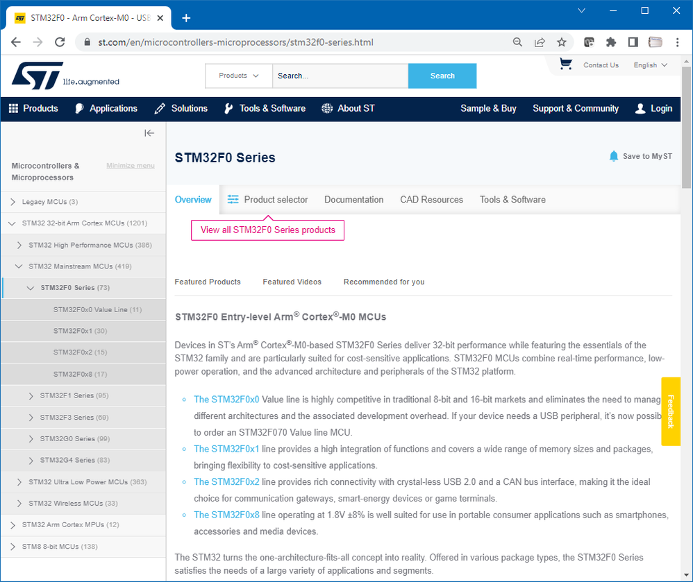

You can look on the ST Product Pages; eg,
although, from that, it looks like F0 has only USB Device?
So look at the other families...

"suggest me a host that can work among the STM MCUs"
There are parametric search facilities on the ST website - see above.
