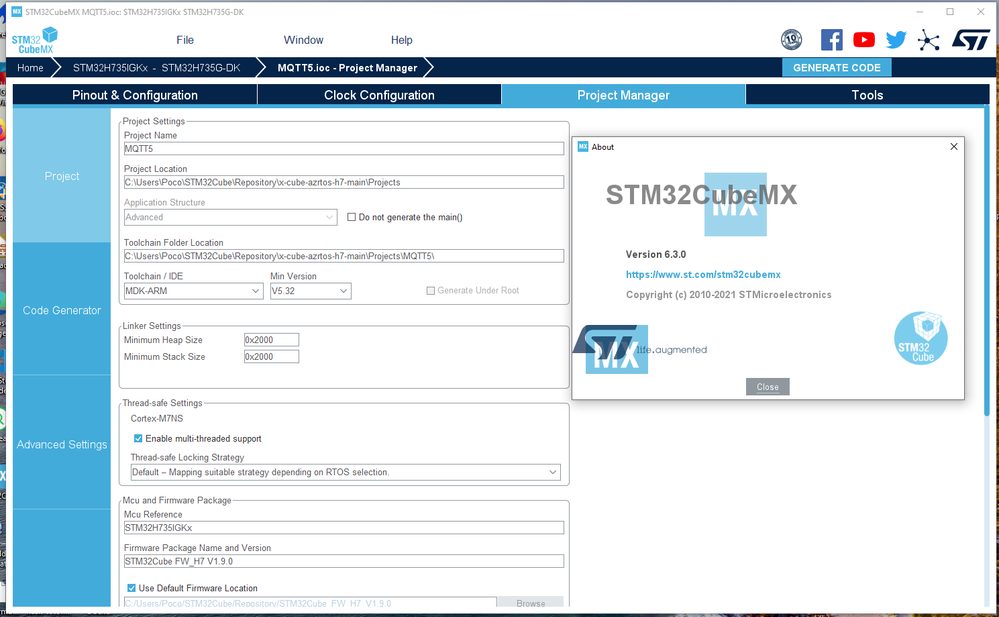

ok, generating a new cube file from scratch in this folder, is this correct ?
C:\Users\Poco\STM32Cube\Repository\x-cube-azrtos-h7-main\Projects\STM32H735G-DK\Applications\NetXDuo\Nx_MQTT_Client
Just selecting the board H735, and start project with default peripherals is this correct ?
enabled multi threaded support
OK, selecting a new folder for the new project: is this correct ?
C:\Users\Poco\STM32Cube\Repository\x-cube-azrtos-h7-main\Projects (project name MQTT5)
Generate files
ok, done, Cube file attached

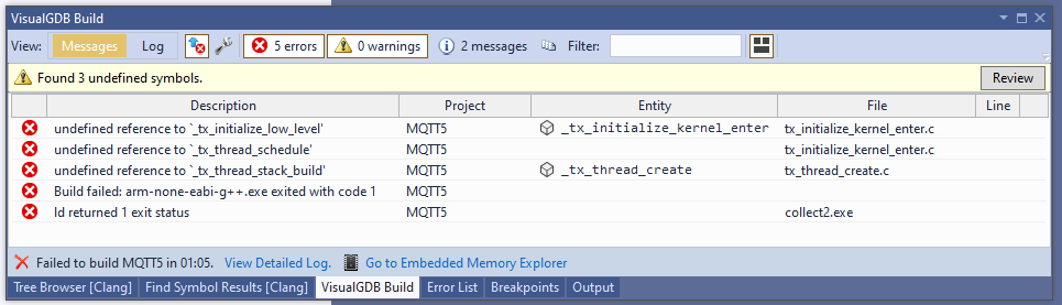

and compile

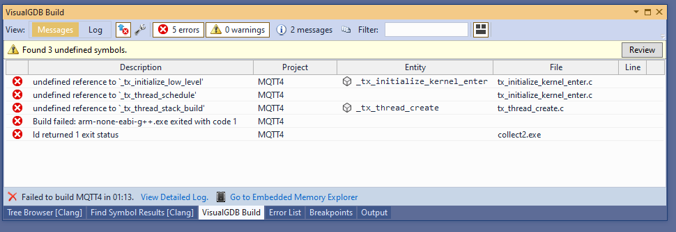

with this result:
so either way the results are the same,
Yesterday I was following the Getting Started Video and selecting the Azure software set inside the cube
the cube decided to use the Azure 1.0.0 files and it downloaded them to compile and give the fails I reported 2 days ago.
