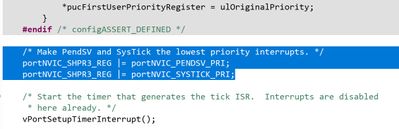

2025-07-18 12:04 AM
Hi.
Could you please let me know how to resolve this issue?
Hard Fault happens in below code
2025-07-18 1:21 AM
Ah so now the fault occurs in a different place? please use the CubeIDE Fault analyzer to get more info on the reason of the fault.
Hopefully SBSFU experts can look at this thread and clarify how SBSFU can coexist with FreeRTOS.
2025-07-19 4:42 AM
Hi.
What should I do when I change like below?
#define SFU_ISOLATE_SE_WITH_MPU -> #undef SFU_ISOLATE_SE_WITH_MPU
Hardfault happens when I change like above.
