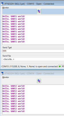

/* USER CODE END 3 */The first HAL_UART_Transmit is to UART1, configured as full-duplex.
This works fine - the full string is transmitted each time:
The second HAL_UART_Transmit is to UART2, configured as Single Wire Half Duplex.
This does not quite work - only the 1st two characters are ever transmitted:
If I single-step the transmit loop in the HAL_UART_Transmit for UART2, it does transmit the entire string.
So what's going on here? Is there some gotcha! with Single Wire Half Duplex?
(Screenshots are from YAT; same results when using TeraTerm)

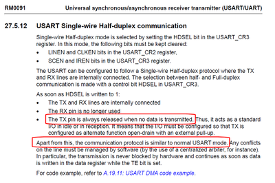

"Datasheet says that happens in hardware"
Well, sort of ...
What the datasheet is talking about is just the input/output setting of the hardware pin.
The user code does have to manage the enabling & disabling of the UART peripheral's transmitter & receiver.
The problem is that the generated initialisation function leaves both the transmitter and the receiver enabled!
This is what causes HAL_UART_Transmit to fail.

"Then go through that function and find what's happening when the half-duplex select bit is set"
Yes - doing that...
Not seen anything in Ref Manual yet that suggests the operation should be any different at all.
"you could still manage the half-duplex by yourself, always turn off the transmitter after each transmission"
Datasheet says that happens in hardware.
2023-08-04 2:31 AM - edited 2023-08-04 2:32 AM
Well, sort of ...
