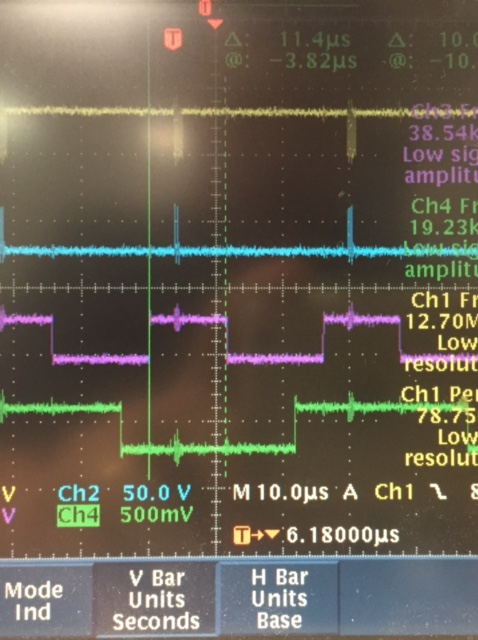

I am working with the STM32L486 using the CubeMX tool and running into some SPI issue that I can't seem to figure out (I am new to ST chipsets btw). Specifically the
HAL_SPI_Transmit routine takes to long compared to the fraction of the time the data is transmitted, as can be seen in the scope image below with yellow being the clock, blue being the data and pink the test point PA0_SET I wiggle (code below). The scope shows that theHAL_SPI_Transmit takes up to 4uS, which is ridiculous. Any idea how to speed this up close to the time it takes for the data to transmit (around 1.44uS)?

Spi.Status = HAL_SPI_Transmit(&hspi2,(uint8_t *) &DDS_Cmd, sizeof(DDS_Cmd)>>1, 2); PA0_CLEAR;Solved! Go to Solution.

It runs twice as fast now, taking about 5uS instead of 11.4uS. Would love to run faster but you can never get away completely from all the flag checking customary with SPI I guess.
