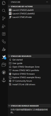

Hi, the extension version is 3.8.0, and it usually takes 5min to load, is that normal? Also, is there any CDN or dedicated server for Chinese users? cuz it's troublesome to download those bundles here. Thx

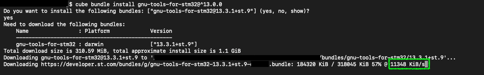

2026-03-31 7:45 PM
Without proxy: 7000 KB/s
With proxy: timeout
I've put *st.com into the proxy whitelist; it shouldn't affect the download speed.
