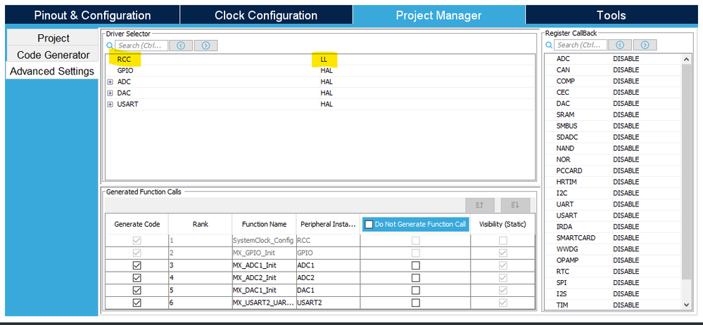

I recently faced the same issue of HAL_RCC_OscConfig() taking too much space in flash. I solved the issue with a very simple trick.
Just change HAL to LL for RCC driver selection in CubeMX code generator in Advanced setting.
Magically, It reduced Code size by almost 40%.
Hope this helps!
