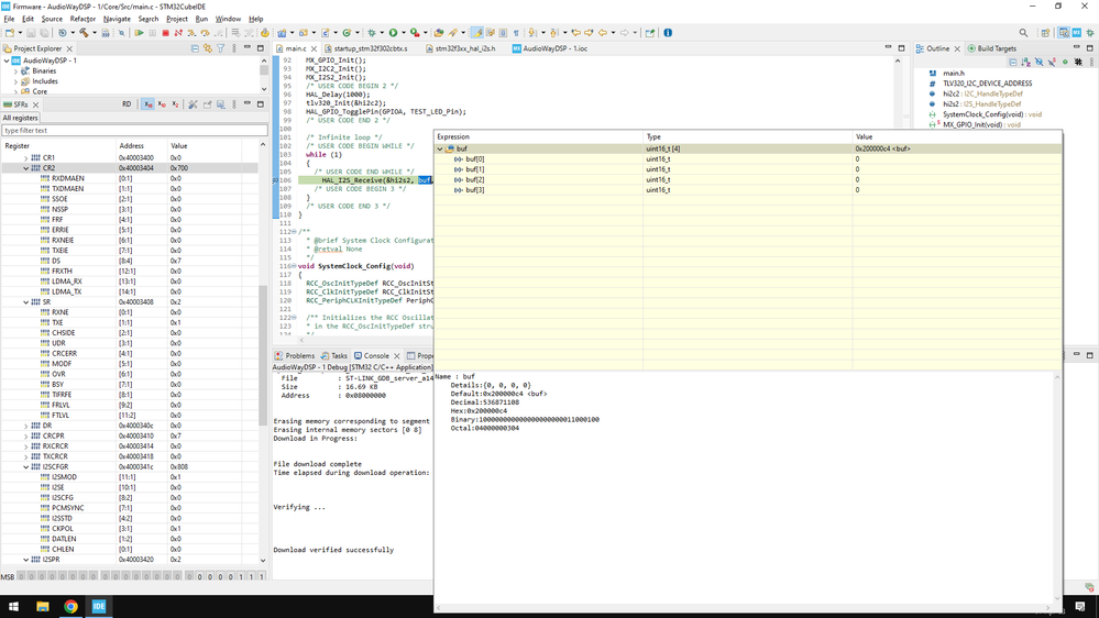

For a week i've been trying to configure my stm32f302cbt6 and the tlv320aic3254 codec to trasmit data to the mcu through i2s_ext_sd but HAL_I2S_Receive returns 0s to the buffer although i see data coming out of the codec. I have configured i2s2 peripheral, master clock in the pinout config, i configured the codec analog input and clocks to generate sample rate and all clocks and bit depths i've checked with the osciloscope seem to be within spec. i ve also called HAL_I2S_MspInit(&hi2s2); in the MX_I2S2_Init(void) function to set the default pins and played around wth the different setting but no luck.
Is there something obvious i am missing?

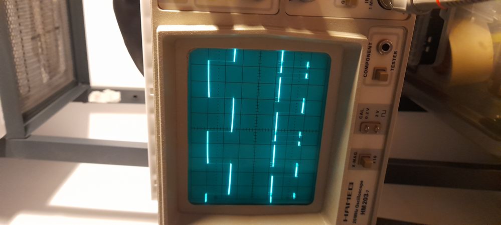

16bit wclk and left and right codec data going into mcu

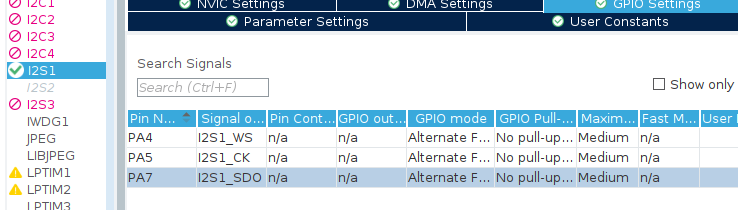

>miso-x-mosi you mean trying on spi.
no. just swap the two lines . (because i made this mistake, get zero data, because master IN connected to slave IN .)
and when set I2S in Cube, you can see, which pins are used, and the mode.
2023-04-01 6:11 AM

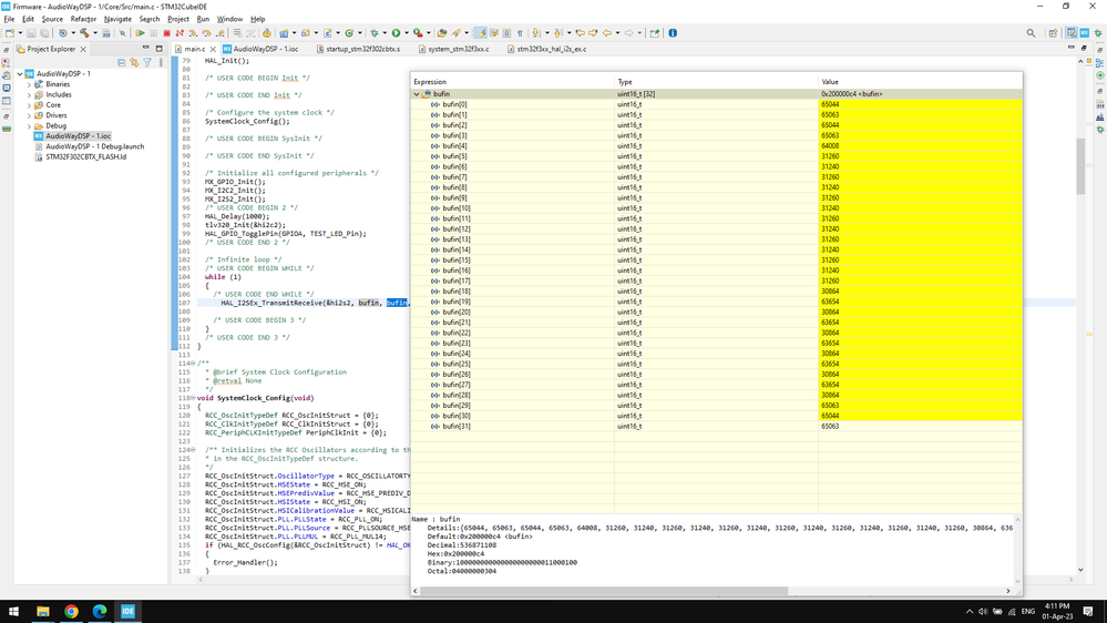

Well AScha.3 thanks for the response! Btw for a reason i cant change the send/receive pins from the .ioc
configurator for a reason! i used HAL_I2SEx_TransmitReceive and now i have real time data filling the buffer but i i also had to change hi2s2.Init.Mode from I2S_MODE_MASTER_RX to I2S_MODE_MASTER_TX.
