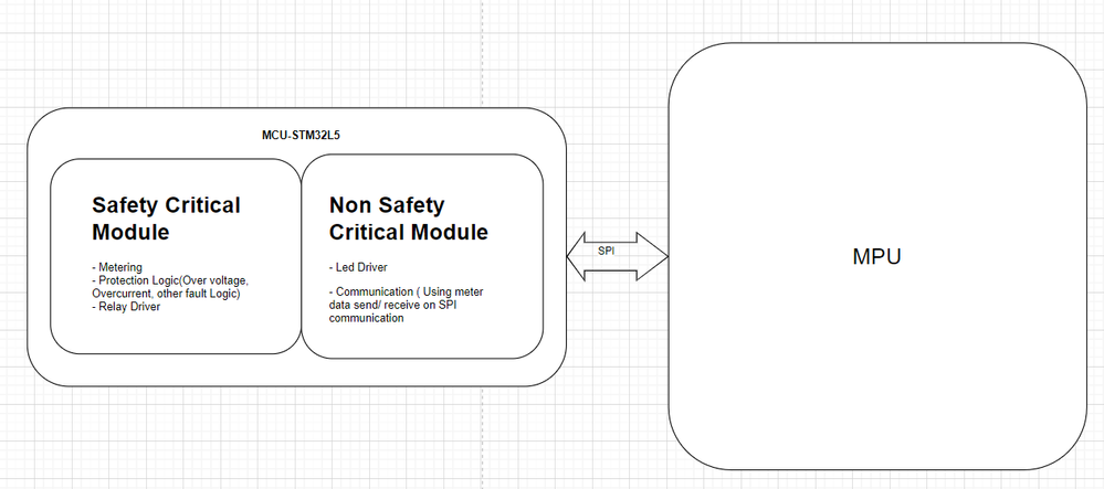

I've attached an image of a block diagram. we will be considered modules for safety-critical and non-safety-critical as per the block diagram
We will provide CRC of safety-critical flash areas when we will go to certification. If I change the non-safety-critical code, this safety-critical flash area CRC must not change.
So, according to your suggestion, does the STM32L5 Series support this type of isolation? If you have any examples or documents, please share them with us.
