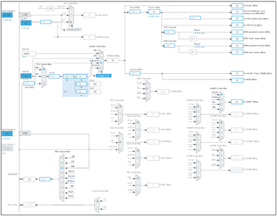

Together with a document I received from a colleague, I managed to get the TCXO going!
Drift is pretty much gone now: I only got 16ms drift over the course of 3600s.

I will try and see if the logic proposed by @Tesla DeLorean makes it more stable - 16ms on 3600s is ~44ppm drift, ideally I'd get to half of it. But this is definitely usable!! Thanks everyone!
For anyone ending up here - see the attachment chapter 7.5 for the HSE/TCXO settings, and see my Clock configuration in the next image.
2024-10-16 7:47 AM
Correction: 16ms on 60m is 4.5ppm, not 44.5ppm so this definitely ticks all the boxes as I hoped for <10ppm. Yay :)
