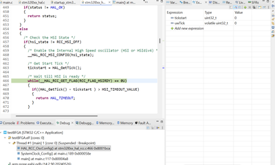

However, I've observed a cold-start issue:
  • If the power supply is disconnected for 3–5 seconds or more, the system hangs and never reaches the main while loop after reboot.
  • If the supply is disconnected for a short interval or a manual reset is applied, the system boots normally.
While debugging, I suspected that the LSE/LSI/HSI oscillators might need more time to stabilize.
Looking into HAL_RCC_OscConfig(), it waits for the HSI to be ready by checking RCC_FLAG_HSIRDY with a timeout mechanism:
 /* Get Start Tick */
        tickstart = HAL_GetTick();
        /* Wait till HSI is ready */
        while(__HAL_RCC_GET_FLAG(RCC_FLAG_HSIRDY) == 0U)
          if((HAL_GetTick() - tickstart ) > HSI_TIMEOUT_VALUE)
            return HAL_TIMEOUT;
When I set a breakpoint here, I noticed:
  • tickstart is always 0
  • HAL_GetTick() always returns 0
It seems the HAL tick is not advancing at this point, causing the function to hang indefinitely.
Has anyone encountered a similar issue, or can explain why HAL_GetTick() would not increment during system clock configuration at cold start? Any suggestions on how to fix this would be greatly appreciated.

Hi @Saket_Om , are you able to get the tickstart value? For my side is always 0 as shown in image below.
