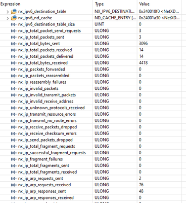

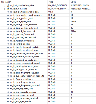

I stripped all logic out of the code and now I'm just trying to run ST generated code from the CubeIDE. The code is configured to load AzRtos, ThreadX, NetxDuo. There are no user threads defined, and it just uses the threads that AzRtos setup. It works at 400MHz (packets received)
at 480Mhz, no packets get through, only ARP packets
very strange....

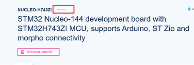

Maybe because you tried to order NUCLEO-H743 which is indeed obsolete:

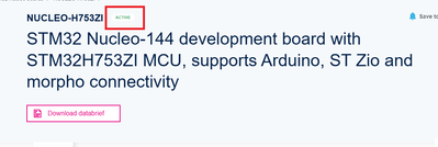

While NUCLEO-H753 still active:
The two chips are compatible. H753 has just the cryptography feature. So you can run any example on STM32H753 generated for STM32H743.
