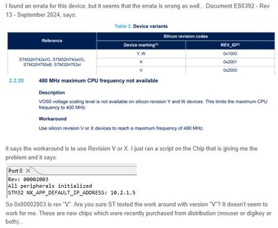

Hi @mbarg.1
I found an errata that says there is a hardware problem with some revisions of this chip. Cannot go above 400MHz...
I think we recently purchased these chips from distribution....

Hi @mbarg.1
I escalated the issue to ST engineers, but it seems their Errata is wrong. I'll wait to hear back from them before sending you a kudos :)
thanks
Matt

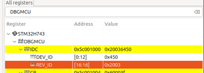

I usually check for counterfait devices in SFRs.
my devices are

As it's generated with CubeMx/CubeIDE I don't think there is an issue in the clock config and indeed rev V can reach 480MHz with VOS0.
I'm not expert of ETH but does the product run with a simple example at 480MHz? What is the product package are you using?
See also this errata:
