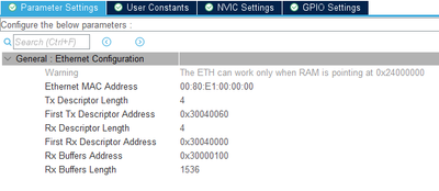

Ok, I finally figured it out and got it to work. The settings in the ETH configurations were wrong and I updated them as follows:
Under ETH configuration, the memory locations have to be updated to:
Note: When using NETX, the "Rx Buffers Address" parameter is not used anywhere in the project, and can be ignored. This was replaced with NetX (.NetXPoolSection)

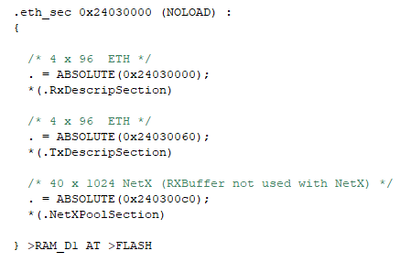

Finally, in the dot.FlashID file, these lines need to be added:
Everything started to work after making these changes

I'm having the same issue... I downloaded your demo from https://github.com/stm32-hotspot/NUCLEO_H743_NetXDuo_UDP_IPv4_IPv6, and the demo doesn't seem to work. I tried it on 2 nucleo boards, with no success. One thing I noticed in the project is the ethernet memory map. When I click on the Connectivity->ETH, It generates a warning:
Are you sure the memory is setup properly in the demo? Also, its not clear how a user can see the memory map after compiling in the STM32CubeIDE. Where is the map that shows where the Rx_Descriptors/Tx_Descriptors are allocated.
2025-02-15 9:40 PM
Ok, I went through the NetxDuo code, and finally figured out what they were doing. Everything associated with the NetxDuo, runs out of the .NetXPoolSection which includes the thread stack. Anyway, now that I have a better understanding of the NetXPools, i was able to get it to work reliably.
