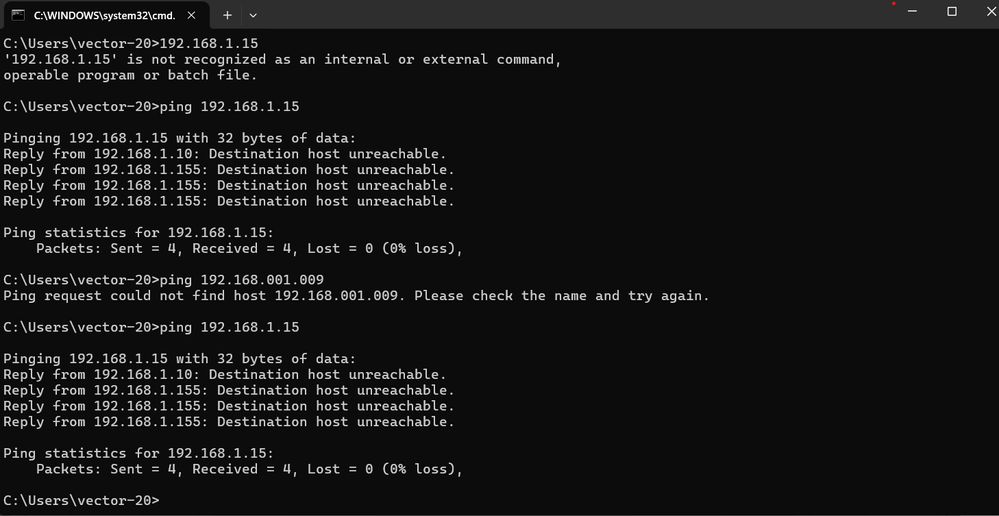

I am currently working with the Nucleo H723ZG board and facing issues establishing a ping response using the LWIP stack. Despite following various examples and configurations, I have been unable to get it to respond to pings. Here are the details of my setup:
I have tried multiple versions of the H7 package ( 1.12.1 - 1.12.0 - 1.11.1 - 1.11.0 - 1.10.0 ) and tested various configurations without success. The ping command consistently results in "destination host unreachable."Could anyone provide insights or suggestions on what might be missing or misconfigured?

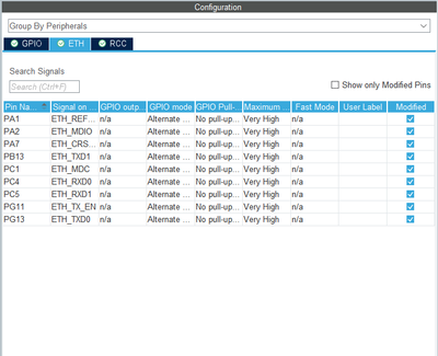

Ethernet GPIO Configuration:

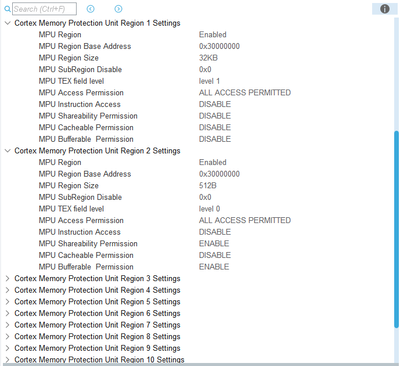

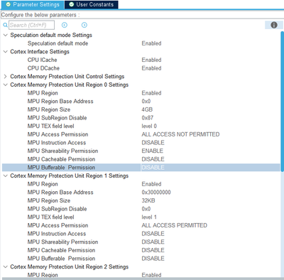

MPU Configuration :

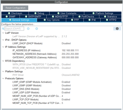

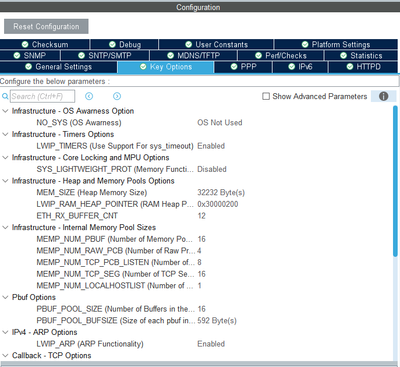

LWIP configuration :

ressult:
My CPU clock is 520Mhz. I am sure the hardware has no problem because I can give a ping from the st package example.
But when I configure according that example it does not work.

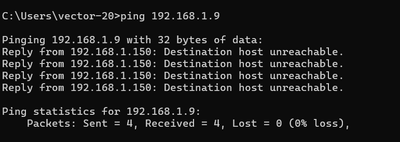

A few weeks ago, I encountered a significant hurdle while implementing Ethernet functionality on an STM32 microcontroller. The complexity of the task led me to seek assistance in formulating a comprehensive questionnaire to better understand and address the issues at hand.After thorough research, experimentation, and persistence, I'm pleased to announce that I've successfully resolved the problem and implemented a working Ethernet solution. This breakthrough marks a significant milestone in my project and enhances the capabilities of the STM32 microcontroller I'm working with.Below, I'll share the details of the solution I developed, hoping it might benefit others facing similar challenges in their embedded systems projects:
MPU setting:

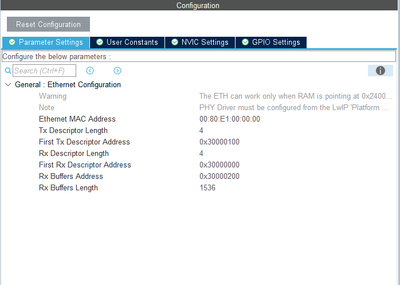

Ethernet Setting:
LWIP :
I added this part to the STM32H723ZGTX_FLASH.ld file:
.lwip_sec (NOLOAD) : {
. = ABSOLUTE(0x30000000);
*(.RxDecripSection)
. = ABSOLUTE(0x30000100);
*(.TxDecripSection)
. = ABSOLUTE(0x30000200);
*(.Rx_PoolSection)
} >RAM_D2 AT> FLASH
I added this to while(1)
MX_LWIP_Process();
