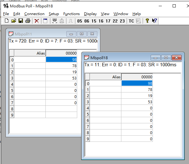

i was try to implement modbusTCP on STM32F7
my STM32F7 is modbus slave and my PC is modbus master for simulation.
it was work but have one question:
my modbus slave will store data to all slave(1-248), in normally, i should be store data to own slave only.
How to fix that?
i use freeRTOS to listen TCP

}eMBErrorCode

}eMBException
