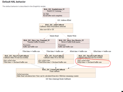

What led me in the correct direction is this fine drawing I stumbled over on the internet:
Due to the 4 I2C addresses I need to get the STM32 MCU to listen on, I had defined the buffer size as an array with 4 indexes, and told the callbacks to finish after 1 byte received from I2C.
Looking at the drawing, It actually make sense afterwards that the SlaveRxCpltCallback never was called when 3 bytes was missing :)

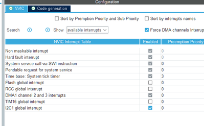

Have you enabled the I2C interrupts in I2C configuration, NVIC tab?

2025-03-04 1:43 AM
After my current knowledge, I will say yes to the interrupt is correctly set in the NVIC
2025-03-05 12:11 AM
@SteenA wrote:What led me in the correct direction is this fine drawing I stumbled over on the internet
Good find - please give a link to that.
2025-03-05 1:05 AM
Here is the requested link to this, at least for me, very useful drawing about the I2C implementation in HAL:
https://code.electrolab.fr/spino/cubesat_cs/-/blob/1D-kicad/STM32Project/code_doc/i2c_hack.md
2025-03-05 1:33 AM
Thanks.
The GitHub Author wrote:The STM32L451 HAL doesn't directly support variable length message RX/TX.
Sadly, this is a common failure of STM32 HALs - particularly also in the UART drivers
