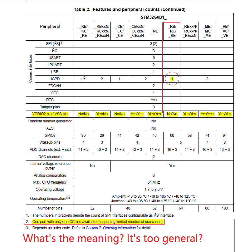

I find there are a note for 'GP' version LQFP64 package.
In blank of UCPD, which has the number "1" .
The note is: One port with only one CC Line available(supporting limited number of use cases).

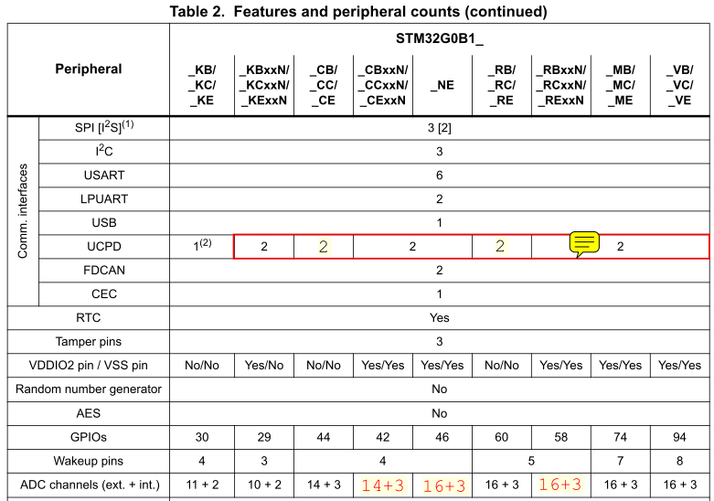

Datasheet release fixing this table is under publication process. For LQFP64, there are 2 UCPD's available, as listed in the pinout tables. Sorry about the difficulties.
