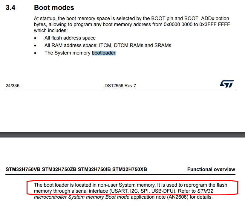

@Javier1 wrote:What does that mean "you can activate the FDCAN bootloader with only by PH13/PH14 pins."?
It means that those are the only pins you can use - you cannot use any other pins.
@Javier1 wrote:@DBign.1 Those pins dont exist right?
Which is, presumably, why the datasheet doesn't mention FDCAN as a bootloader option:
https://www.st.com/resource/en/datasheet/stm32h750vb.pdf#page=25
Similarly for the stm32H743ZI:
2025-01-16 4:41 AM
if you go look into AN2606 youll find there is supposed to be a canbus bootloader for this mcu
2025-01-16 4:43 AM - edited 2025-01-16 4:45 AM
Yes, looks like AN2606 makes some sweeping generalisations - which aren't always true.
