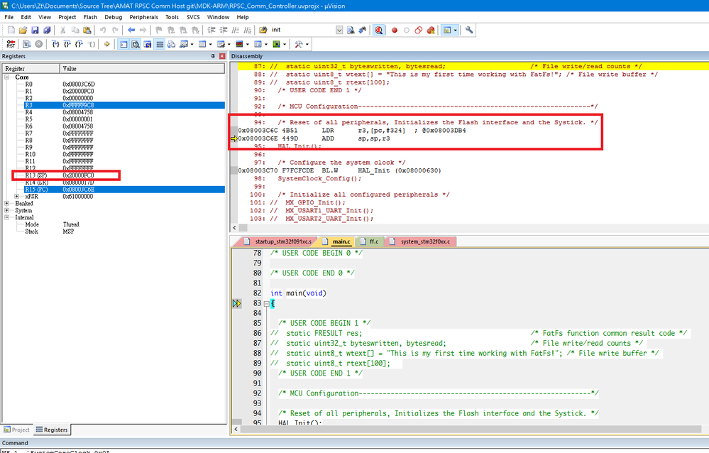

Now I open my IDE and prepare to see how SP Register is going to grow,
Just in the main loop, not beginning doing anything, I got the above bizzare two disassembly
0x08003C6C 4B51 LDR r3,[pc,#324] ; @0x08003DB4
0x08003C6E 449D ADD sp,sp,r3
when these two instruction are executed, and then begin to HAL_Init(), my stack point immediately run to
0x200000988 ->already stack overflow!
I would like to know what is taking these gigantic stack memory, just in the beginning of main loop!!
attached files are my map file and startup file.
I use cube MX and microlib option is enabled in the Keil IDE.
Please help me and thanks for reading this post!
