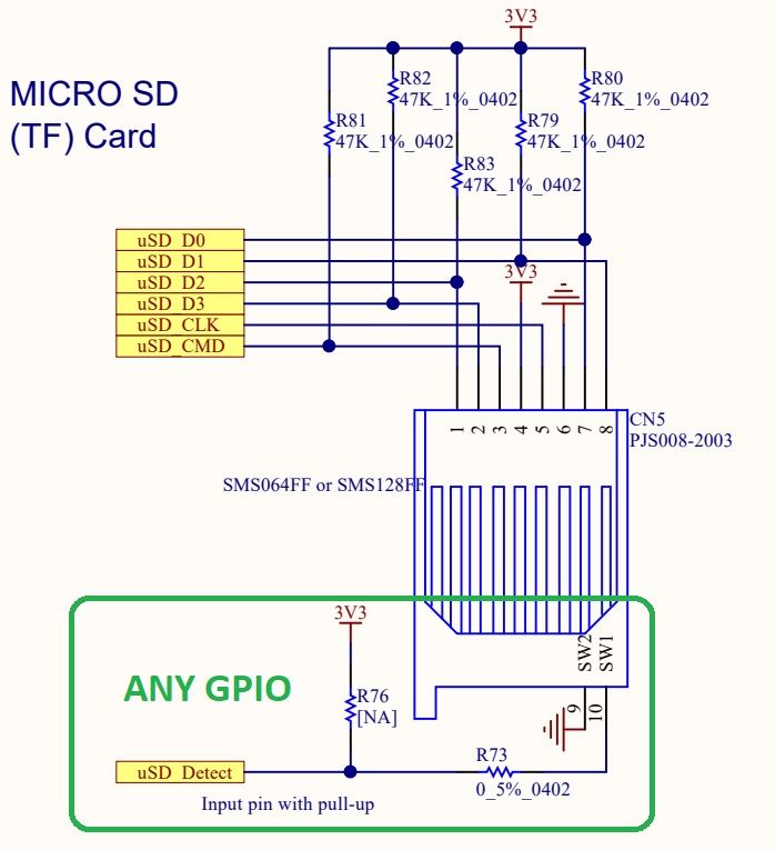

I'm working on a project that involves using FATFS and I was curious if I had to use the specified anti-tamp pin that gets shown. I declare other input GPIO, but only PC13 shows up as PC13-ANTI_TAMP

What project? What pin selection?
The MicroSD Card sockets typically have a Card Detect pin, frequently closure to ground, that you can connect to ANY GPIO, and either Poll or use as an EXTI source.
More or less answers my question.
