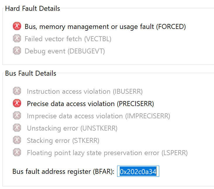

2019-10-23 10:37 AM
Furthermore, analyzing the hard fault, i get :
