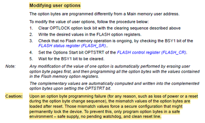

Thanks Andreas, I've just found this information at STM32G031 Reference Manual:
Just one question, which Errata are you referring to exactly?

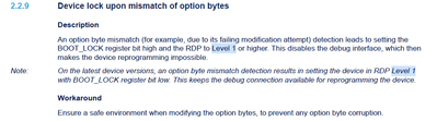

2024-04-09 9:11 AM
ES0487 - Rev 6 - September 2023, 2.2.9
2024-04-09 9:14 AM
Thank's!
I've just found at ES0418 from STM32G031:
This is the real problem that has benn occurred...
