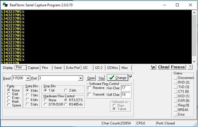

2016-11-10 11:18 AM
What does it actually output?
The RNG must have its AHB clock enabled, and the PLL Q must be clocking and outputting 48MHz. Things won't work if the PLL isn't running.Review the Reference Manual, examine the registers and settings directly.2016-11-10 11:21 AM
Don't exit main()
Provide output fromwhile(1)
DEBUG_PRINT(''%'' PRIu32 ''
'',code_[0]);
HAL_RNG_GenerateRandomNumber(&hRNG1,code_);
2016-11-11 1:56 AM
2016-11-11 8:20 AM
Does this work?
code_[0] = 12345;
'',code_[0]);
I might examine the RNG hardware on the F4 under the SPL if I get time. You should review the Reference Manual, and output/advance the registers manually.
