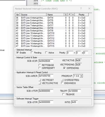

If the interrupt is being triggered, there's a reason for it. Set a breakpoint in EXTI8_IRQHandler and examine the state of pins and registers to determine why it's being called. Look at VECTACTIVE to make sure the correct handler is being called. (Compare the value VECTACTIVE - 16 to those listed in IRQn_Type.)
2025-01-02 8:33 AM
Thanks for your answer,
I get VECTACTIVE = 0x28 when it triggers the EXTI8 And nothing on EXTI9. With and without input signal.
I tried to use HSI - the same behavior.
I am pretty sure it comes from the MCO1, It generates 2.2MHz. If it is OFF, EXTI9 is not triggered but still does not respond to the external signal.
2025-01-02 9:04 AM - edited 2025-01-02 9:06 AM
0x28 - 16 = 24, which is EXTI8_IRQn, so that lines up. Something is triggering it.
Makes sense. Perhaps PD8 is not hooked up to what you think it is, or the EXTI8 interrupt is not set to PD8. Note that MCO1 output is on PA8, which is the default EXTI port.
Look at SBS->EXTICR2 and ensure lower 4 bits are set to 0x3.
2025-01-02 11:02 AM
Read out and check/post content of relevant GPIO and EXTI, and as @TDK said above, the EXTI steering registers.
