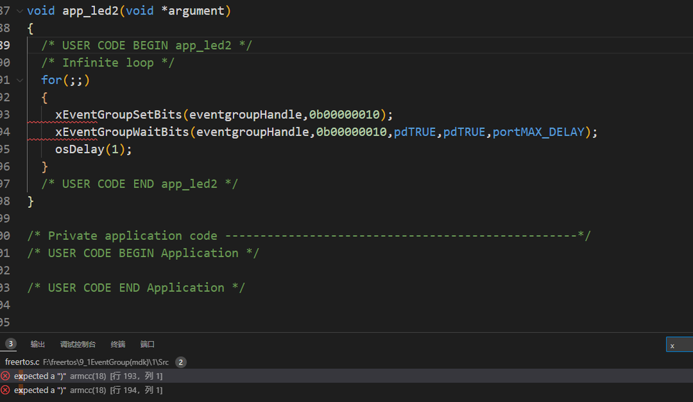

I am trying to generate initialisation code for CubeIDE using MX. Functions starting with ‘xevent’ compile successfully in CubeIDE, but in MDK it reports an error indicating that ‘)’ is missing before the function. Do you have any idea what is causing this?

Do you mean you have an issue with MDK-ARM (Keil)? if yes what version are you using and what ARM compiler version you set? and if possible to share your project to reproduce the behavior from our side.
