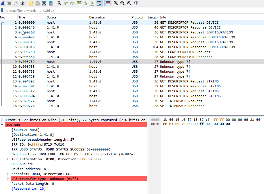

Hi @Johannes can you please share with an usb trace of your device enumeration, or you can port Ux_Device_Video with STM32H7A3-Nucleo to ensure that it work and then intergrate it in your application.

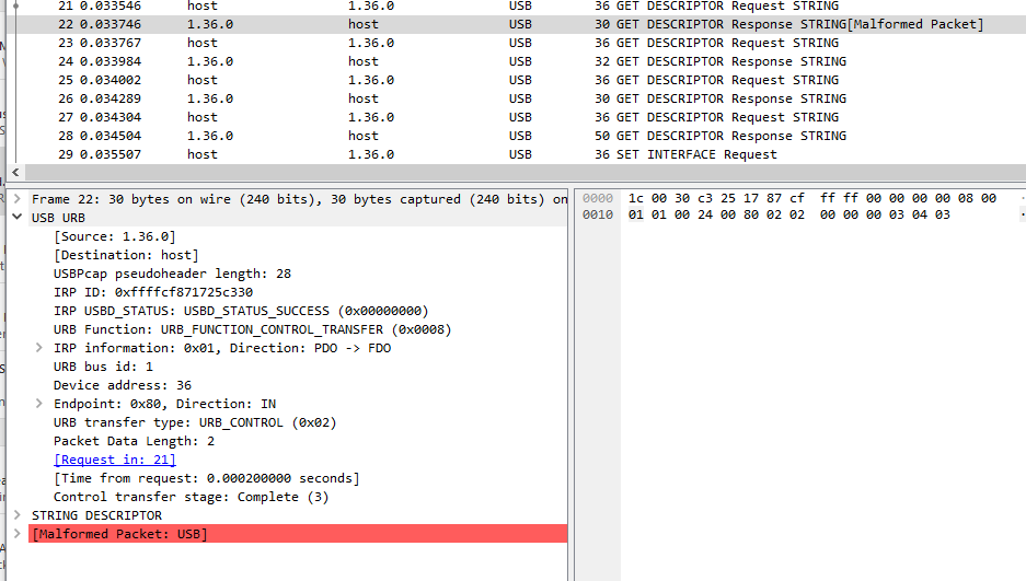

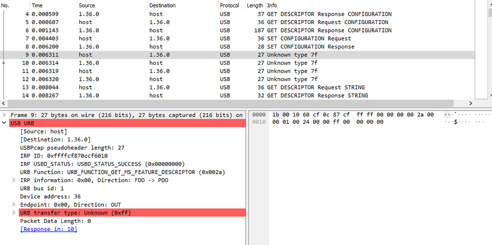

I have a wireshark USB trace. There are multiple strange packets:
And a malformed packet
The rest of the packets are related to MSC storage, i think

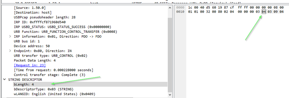

2023-05-12 7:41 AM - edited 2023-11-20 5:42 AM
If a package is "ok", this seems to be the position is the lengh information of the payload
bLengh = 4, 1 byte "bDescriptor type" and 2 bytes payload = 4 bytes.
In the malformed package
bLength = 4, but only the bDescriptor is following and 2 bytes are missing
