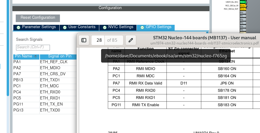

(1) This is CubeMX and the MB1137 board documentation side by side and the PA7 doesn't agree. If I try to change it to the correct value, then ETH module gets automatically disabled.

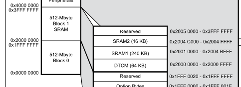

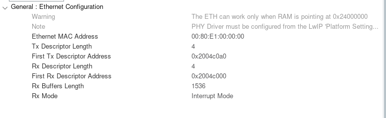

(2) When I configure ETH there is warning message: "The ETH can work only when RAM is pointing at 0x2400 0000." I don't understand this warning, that address is in reserved area:
Maybe the warning message means the DMA descriptors should be after 0x2004c000. In that case the default config is good. On the other hand, according to the rm0385, ethernet DMA has access to all memory, so this shouldn't be an issue even if I got it wrong.

(1) HAL_ETH_MspInit() should be updated with the correct config (UM1974: User manual: Table 11 Ethernet pins :(
You can update ETH GPIO Settings in MX, click on the right GPIO and choose the correct setting;
Relocate ETH_TX_EN signal from PB11 to PG11.
Note: You should set the new pin (PG11 in our case) to its correct config rather than disabling the wrong one, that way the ETH module doesn't get disabled.

(2) For the DMA descriptors, the default config is good Ethernet Rx and Tx DMA Descriptors are pointing to the right locations.
