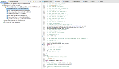

Since I last replied, I have done some debugging with the toggle pins and breakpoints up to line 200 in the main.c file. I would specify the locations of those but I have been able to determine at what point the code is failing. I placed a GPIO toggle for PB14 at line 187, before the osKernalStart line at 193 and then placed a GPIO toggle for PB14 at line 199 to turn it off. It never reached the turn off point location at 199. I placed a breakpoint at osKernStart and then singled lined through until I reached the file ethernetif.c - the code stopped working at line 482. I have included the snippet of that section below, the line highlighted in blue is my error point.

So after reading through that KB article you linked, I decided to start again from scratch. I saved my user code in visual studio for later once I can get the ethernet actually up and running. I therefore created a new CubeIDE project and followed along exactly with the article. I then added breakpoints and a GPIO toggle just before the osKernalStart and after. Unfortunately, my code still does not leave the osKernalStart. However, this time it is getting stuck in a different place, specifically memp.c. I will provide a screenshot of the location and code:

2025-06-12 10:41 AM
I realize I should have specified, it creates an endless loop and never leaves!
2025-06-12 11:08 AM
I will also include this, so if I press F8 once the osKernalStart() breakpoint is reach, this is what comes up in the debug perspective/stack:

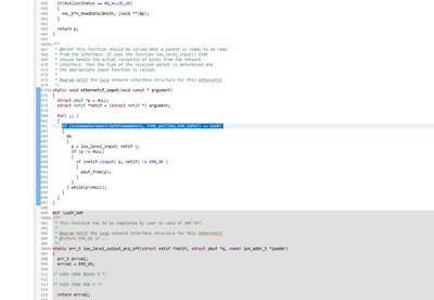

2025-06-13 2:12 AM
Hello @kyleg4032,
You are currently working in a Real-Time Operating System (RTOS) environment, which operates differently from a traditional bare-metal or non-RTOS environment. In an RTOS, tasks are managed and scheduled by the operating system, ensuring that each task gets the CPU time it needs based on priority and timing requirements. This means you cannot rely on traditional infinite while loops to handle your application's logic, as this would block the CPU and prevent other tasks from running.
Instead, you should create a thread (or task) in the RTOS in STM32CubeMX, to define your application's behavior. Each thread runs independently and cooperatively with other threads, allowing the RTOS to manage task scheduling efficiently. This approach ensures that your application remains responsive and adheres to real-time constraints.
Thread creation and configuration can be done in STM32CubeMX FreeRTOS settings under Tasks and Queues. Leave the default task as it is, and create a new task that will handle the execution of your Modbus program flow.
To better understand these concepts, I highly recommend exploring the following:
FreeRTOS Documentation: Learn how to create and manage tasks, use synchronization primitives (e.g., semaphores, queues), and understand task priorities.
RTOS Tutorials: Look for beginner-friendly guides or video tutorials on RTOS concepts to grasp task scheduling, preemption, and inter-task communication.
LwIP Documentation: Familiarize yourself with how LwIP works in an RTOS environment. This will help you understand how to integrate networking into your application.
By studying these resources, you’ll gain a solid understanding of how to design and implement applications in an RTOS environment effectively.
